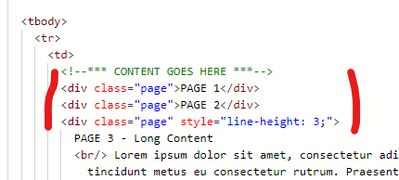

I posted some example Html here https://www.googlecloudcommunity.com/gc/AppSheet-Q-A/If-You-Have-Not-Tried-HTML-Templates-You-Should... that includes code to make a header and footer. I know this is a no-code/low-code platform, so this would be considered a bit more advanced.
That is the one I followed and to eliminate the last blank page I ended up removing the <div class="page"/> tags.
Hi @Markus_Malessa
Yes, that's great. I found this Medium article. This is the same approach !!
https://medium.com/@Idan_Co/the-ultimate-print-html-template-with-header-footer-568f415f6d2a
The only  issue : I always obtain an extra blank page at the end of the generated pdf ?

I am having difficulty when i try to group the output (ie I have an external start to order the data by category , as I want to create a subtotal) The grouping works, but every 'break in category throws a new page
I used this Medium article. And it works great
I don't know the length of my document in advance and the header and footer are created perfectly.

<div style="line-height: 3;">
and the document is paging on every break in category- What i will do is go back to the original guide and start again.
