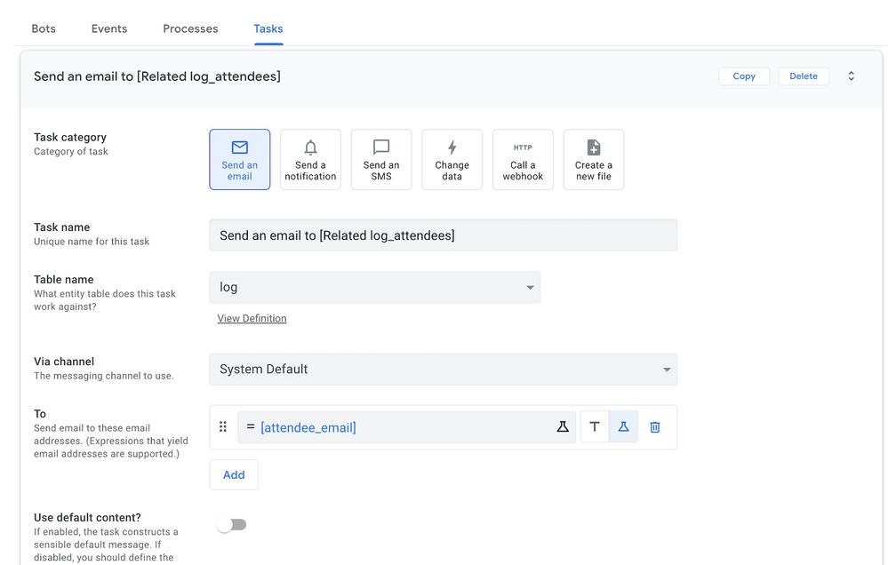

What is this [attendee_email] column type? What values are in it? What does the audit-log/automation-monitor show when this Bot runs?
The values in [attendee_email] is group email

The same thing happens to me, only the mail is sent to the owner. I am doing it from where it is displayed in the photo.
