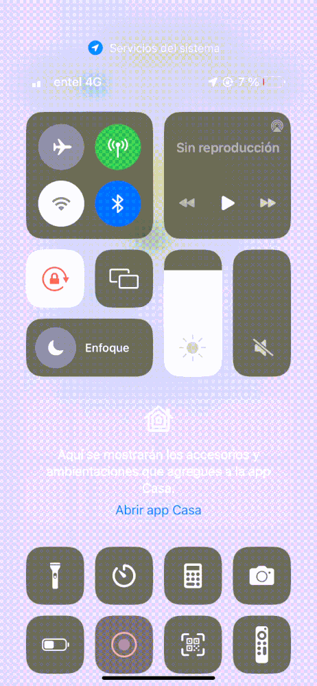

Today 05/18 the problem persist!!
IOS: App Crash
Android: Install Latest Chrome version but already has it
