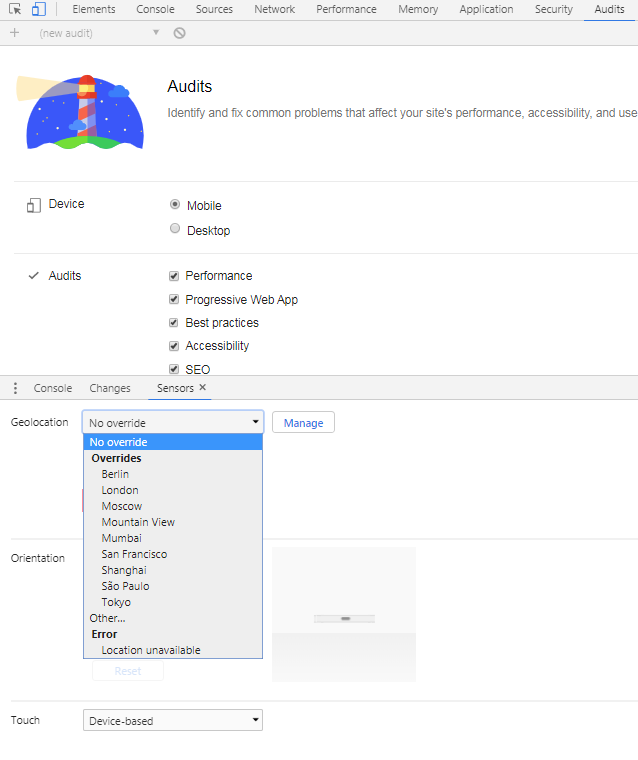

GPS can be spoofed just as easily as device time. With dozens of third party applications directly on a phone, or even directly in a chrome browser with chrome devtools:
