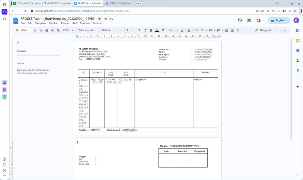

Hi Aleksi..
I still can't make it. I have followed your instructions for the position of setting the PDF template.
Meanwhile, for the behavior set, I have also gone back and forth trying to change the trigger column settings but the result still shows only one invoice number or if I direct the bot to the "enum list" column to be the trigger, then the bot can't process it.
I understand that you have explained it correctly, maybe it's just me who hasn't been able to find the method in practice as you directed

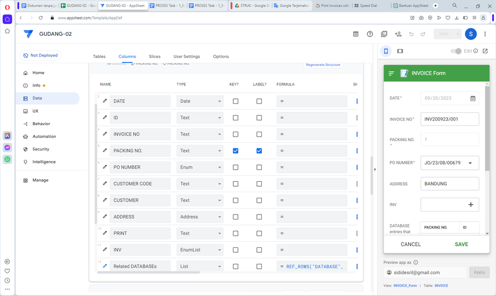

Would you please take a printscreen from your template.

Hi.. Aleksi
Here are some photos of the application that I'm working on and until now I haven't found a solution even though I've tried.The First TableThe First TableBehaviourBehaviourThe Second TableThe Second TableReport TemplateReport Template
