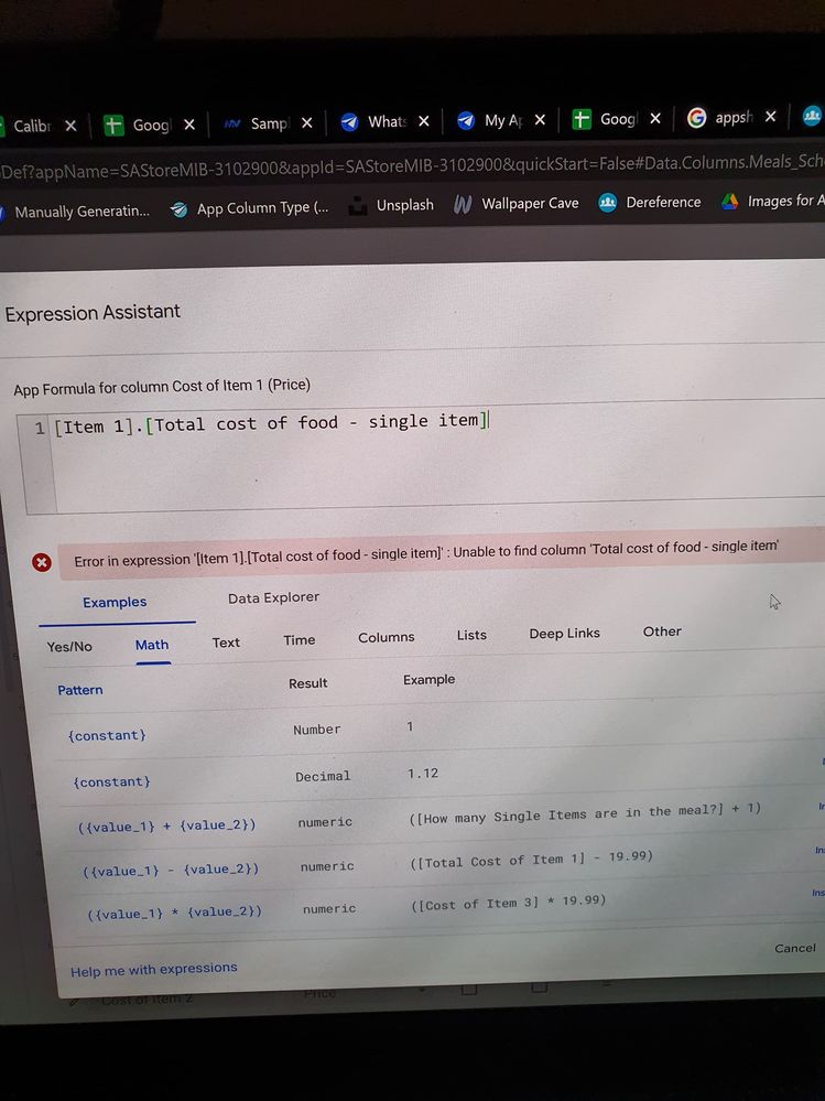

Iโ€™m getting an error and I canโ€™t work out where I am going wrong
I have a ref column
I want to dereference this column from the Single items table
Itโ€™s column 54 of the table โ€œSingle itemsโ€
But when I try to dereference I get the error below.
Iโ€™ve used the appsheet training plugin to insert the column name so the name should be correct but for some reason it doesnโ€™t seem to be looking at the Single items table for the [Total cost of food - single item column].
I donโ€™t know where Iโ€™m going wrong. Can anybody please share a suggestion on what I might be doing wrong?

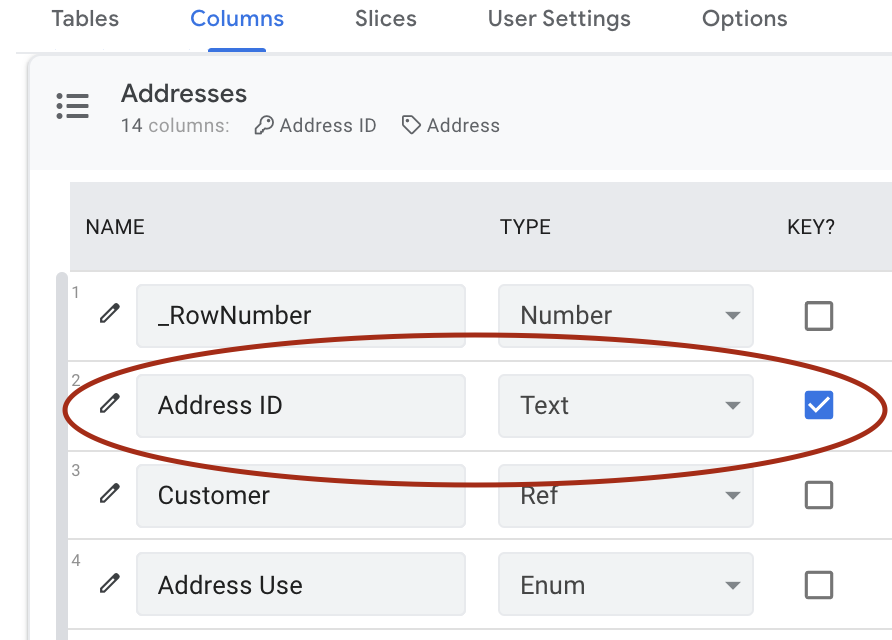

From your screen show we canโ€™t tell which table the column Item 1 belongs to. In that table a column is marked as the KEY column. See image below.
The value from this key column is what should be stored into the column [Total cost of food - single item].
How are you assigning a value to column [Total cost of food - single item]? If you are using a dropdown list - show us the expression that provides the dropdown values.
Make sure that [Item 1] actually has the KEY COLUMN stored in as a POINTER to the ROW from the Single Items table. It MUST store the row key NOT the Price value from the [Total cost of food - single item] column. You will access that Price through the reference.

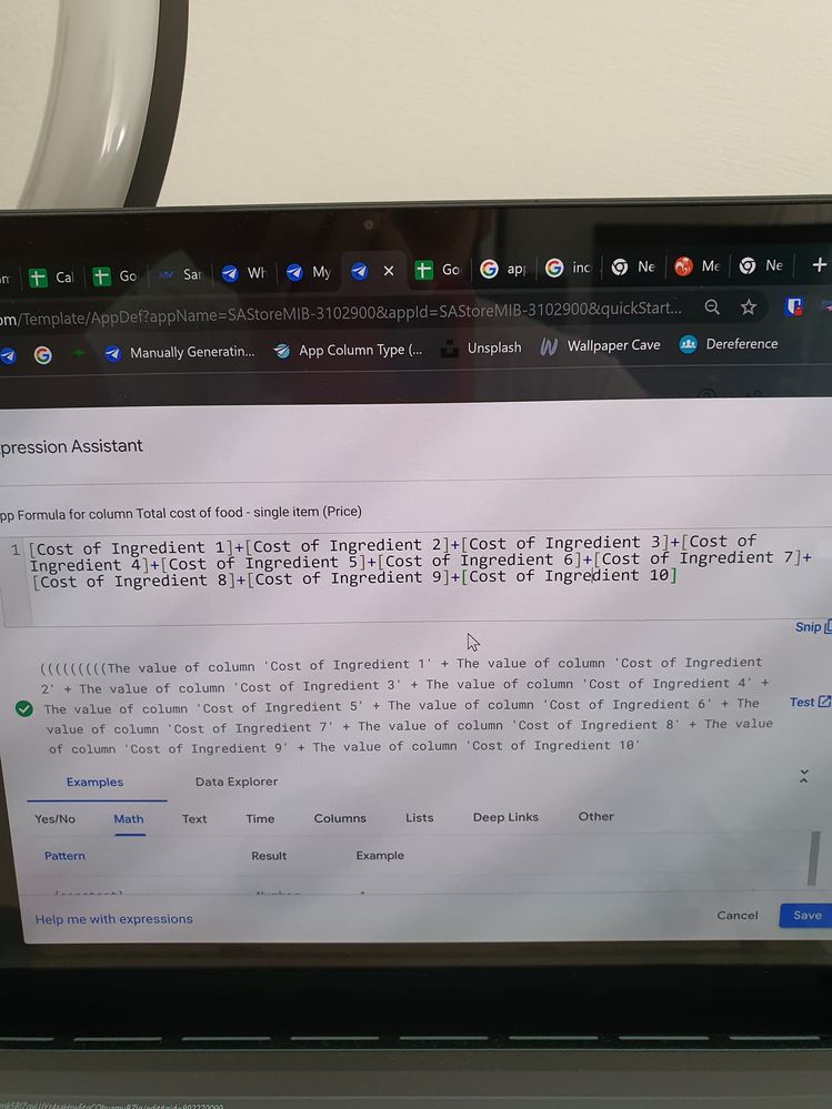

The Single items table has columns for 12 items from the price list via a dropdown and 12 dereferences to the pricing and 12 decimal columns to enter quantities. This is working as expected.
The Menu table where Single items can be added together. It is very similar in structure to the Single items menu in that the intention was to allow the user to choose items from the Single Item table via a dropdown and then obtain the Total cost of food-Single item from the Single items table and be able to combine a number of single items into a meal.
So I used the REF type to get a dropdown from the Single items table which is working as expected and showing me items from the Single items table when I click it.
Item 1 belongs to the Menu table.
