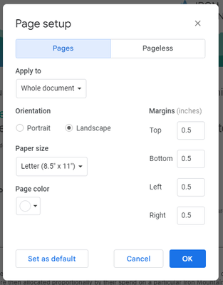

I am creating a PDF from Google Docs, and here is my page setup:

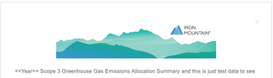

The top part of my document is like this (I added the lower case text at the end to see where it would line-break):

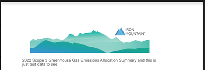

On the generated PDF it looks like this:
As you can see it wraps way earlier in the PDF than in the template.  The PDF is set to landscape also, and both are 8.5 x11 (Letter).  I tried with default margins, with 36 pt margins (which should equal 0.5 inches), and with zero point margins on left and right, no luck.

Do you have 'Landscape' as the attachment page orientation also in the bot settings?
Yes:
