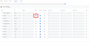

It is recommended to use USERSETTINGS which sets unique values per device.

Public
Filter by USERSETTINGS
Use the slice function, as security filters cannot be used.
The values of the items set in USERSETTINGS are
USERSETTINGS("column name") or [_THISUSER].[""column name]
can be obtained with
Examples
- Added user_email to order table.
・Set email as one of the items in USERSETTINGS.
・Use slice and set the condition to [user_email] = USERSETTINGS("email").
・Use after registering with USERSETTINGS for customers.
By doing the above settings, Public will also display orders filtered by user.
Thanks for your time and effort,
"Use after registering with USERSETTINGS for customers"  this part is not clear.
Go to USERSETTINGS, check show and save.
After saving, a View called Setting will be displayed in the Menu.
Users on the Public side must first register their e-mail etc. in Settings before using it.

I’m aware of usersetting configuration. So you are telling that customer
has to feed their email in usersetting view before log to the orders, am I
right?
In this case I just need to create a feild for user email right no formulas
required.
