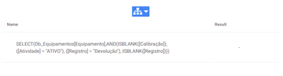

Qual formula usar para continuar a equaรงรฃo :
Ainda preciso colocar, [Registro]="Devoluรงรฃo", ISBLANK([Registro])
Porem meu resultado esta ficando em branco;

Expression Result:

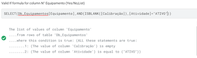

Com a formula inicial:
Expression Result, aplicando as duas formulas restantes na funรงรฃo AND():
Obviously there are no records that meet all conditions, you need to verify what the data is versus what you are expecting it to be, and/or test each condition independently.
Your last 2 conditions are mutually exclusive. [Registro] can't possibly be both blank AND have the value of "Devoluรงรฃo". I don't know what you're trying to do, my only guess is to maybe use OR()?
