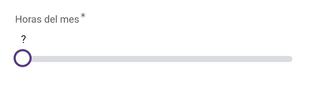

I have some columns set to Number type and configured to show a range while entering data into the form:
First: today it started to show the slider to the left instead of the center of the screen:

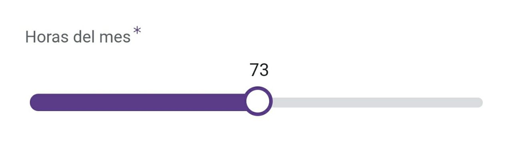

Thatโ€™s not a big problem, the thing is that if you touch/click on a certain point at the left or right of the slider (while itโ€™s centered, for example like this):
It will move the slider exactly to where you touch/click instead of increasing/decreasing by the steps you configured it to do.
This is REALLY BAD for me because:
  1. I told users that they can do the 1-increase/1-decrease thing by touching either side of the slider and
  2. The range is big so itโ€™s hard to be accurate just by using the slider by itself.

I donโ€™t believe that has ever been the behavior of the range slider.
It was until a couple of days.
Before I could change the number by just tapping once at either side the slicer by the number configured inside โ€œIncrease/decrease stepโ€
