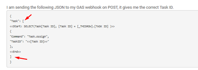

I am trying to parse the response of an AppSheet bot in my GAS web hook on POST, however, I am not getting much of luck.
I am sending the following JSON to my GAS webhook on POST, it gives me the correct Task ID.
"Task": [
<<Start: SELECT(Task[Task ID], [Task ID] = [_THISROW].[TASK ID] )>>
"Command": "Task.Assign",
"TaskID": "<<[Task ID]>>"
<<End>>

var data = JSON.parse(e.postData.contents)
Is correct.
From there, maybe try:
var task = data.Task
Only other thing I see off, is that your array doesn't seem to be coming through.

"You mean that the array isn't coming through at all? If that was the case, e.postData.contents would have been blank. Or perhaps I have missed your point completely."
I mean that you built "Task" as an array in your Bot:
But the content you said you were getting did not have an array in it:

I saw your point about having any array, and I guess it might come down to it. I have updated the JSON body in my template to following, but I am still not able to get Command or TaskID out of it.
As @Marc_Dillon pointed out, the value of "Task" should be an array...
Not sure if this is the cause of the issue, though.

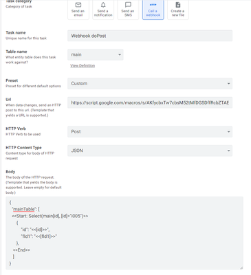

My test template is almost identical to yours.
  "mainTable": [
  <<Start: Select(main[id], TRUE)>>
          "id": "<<[id]>>",
          "fld1": "<<[fld1]>>"
   <<End>>
not sure what is happening with your implementation..

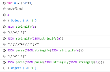

When I was testing, I struggled first and wrote out typeof results to a gSheet to see what I was getting.
What do you get for
  typeof e.postData.contents <= I got "string"
  typeof JSON.parse(e.postData.contents) <= I got "object"
And just to make sure, this is my test Webhook settings for comparison
Basically all default values..
Mine looks exactly the same - default values mostly, and web hook endpoint, table name and JSON.

 I got the below - very interesting the result of typeof(json.parse) (2nd line) but I am getting it as an object value when I tried to write json.parse result (4th line) in the sheet.
  1. type of e.postData.contents -->string
  2. type of JSON.parse(e.postData.contents) -->string
  3. e.postData.contents -->{"Task": [{"Command": "Task.Assign","TaskID": "3"}]}
  4. JSON.parse(e.postData.contents) -->[object Object]

    data["Task"].forEach((tsk)=>{
    //setAppendDebug("tsk type:", getObjType(tsk));
    setAppendDebug("tsk --> ", (tsk)) ;
    setAppendDebug("JSON.stringify(tsk) --> "JSON.stringify(tsk)) ;
Output
Start execution at 08/03/2022 23:03:20
Response of request:TextOutput
Array.isArray(data[Task]) -->true
Task array length) -->1
tsk -->
I have also tried the following but got error
setAppendDebug("tsk[Command] --> "tsk[0]["Command"]) ; //error: TypeError: Cannot read property 'Command' of undefined
setAppendDebug("tsk.Command --> "tsk[0].Command) ; //TypeError: Cannot read property 'Command' of undefined
I was facing the same problem while trying to access the values inside the parsed object that returned from doPost(e).
Maybe you can try to output the following to get the keys and values of the parsed object.
Object.keys(data);
Object.values(data);
In my case, I discovered that my object has length of 1 and its key is '0'. So I just accessed the values as follows:
myData.0.myKey
Hope it helps.

That's bad advice. Webhook payloads are transmitted as a string, so you're stringifying a string. If that somehow works for you, then the payload probably wasn't built properly in the first place. Check out these results:
You were right, I've just edited! Thanks
