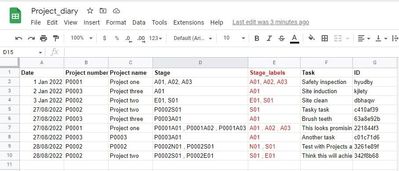

Looking at the Row labels and keys sample app, it appears that there is no way to save the row label in the Form table instead of the key.
This makes sense, because it's the unique key that relates the Form table record to the Person table record.
The label can't be saved to the Form table instead of the key, because labels are not necessarily unique.
With that in mind, I settled on the following solutions in my dummy app.
For project names, I set the project name as the key in the Projects table and stipulate that project names must be unique.
The best option that I could find to return the Stage label in the Diary table was to add a new column to the Diary table that returns the Stage labels as an Auto Compute based on the Stage keys listed in the row.
This was quite simple, as my Stage keys were a concatenation of the project number and the stage number.
I used an Auto Compute spreadsheet formula that removed the the project number and left the stage number.
See screenshot of the table and formula below. New column in red.
If you know of a better way to achieve this outcome, let me know.
Thank you for your help.
