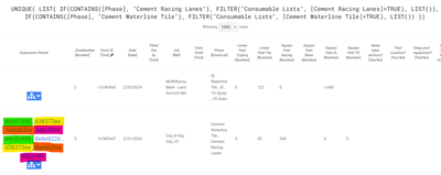

I'm struggling with the formula for my reference rows in this action. I keep receiving the error that it "does not match the expected type List or its expected type details."
Here's the two actions:
the formula is:
UNIQUE(
LIST(
IF(CONTAINS([Phase], "Cement Racing Lanes"), FILTER("Consumable Lists", [Cement Racing Lanes]=TRUE), LIST()),
IF(CONTAINS([Phase], "Cement Waterline Tile"), FILTER("Consumable Lists", [Cement Waterline Tile]=TRUE), LIST())))
I also first tried it with SELECT() which produced the same result.
UNIQUE(
LIST(
IF(CONTAINS([Phase], "Cement Racing Lanes"), SELECT(Consumable Lists[Item ID], [Cement Racing Lanes]=TRUE), LIST()),
IF(CONTAINS([Phase], "Cement Waterline Tile"), SELECT(Consumable Lists[Item ID], [Cement Waterline Tile]=TRUE), LIST())))
The formula itself does not produce an error within the expression assistant, though the UNIQUE() function doesn't seem to be working.
