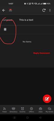

Remove numbers from ref views
I don't want to see numbers in the ref which is as shown in the attachment
Let me know how can we remove it
Thanks in advance

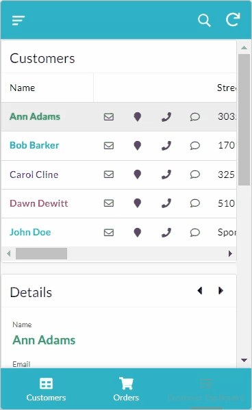

the workaround is to use the dashboard view with interactive mode.

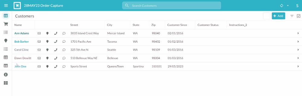

In the gif below, once the user selects the customer record, the detail and related customer order view are displayed. The related view of orders of the customer does not have the record count.
With a LINKTOROW() action that navigates to the dashboard view, it will look still better. The dashboard view will have the detail and related records view. The LINKTOROW() action can be set as row selected action in the summary table view.Related Views -2.gif
