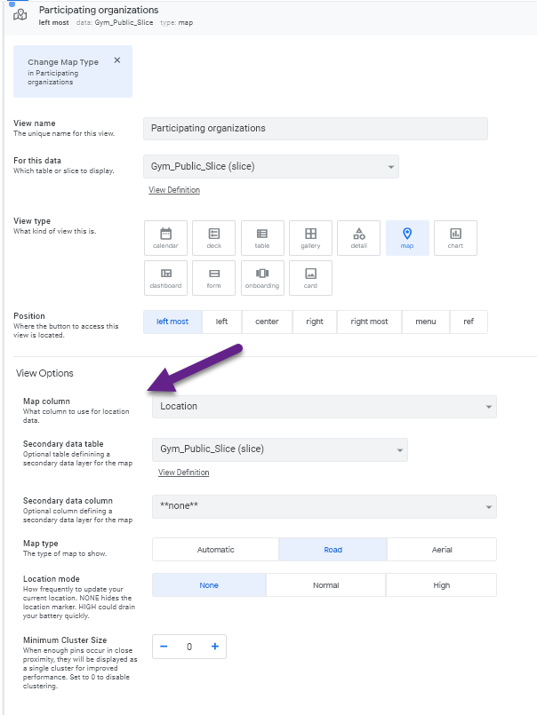

There is no Show_if constraint on the Location field. I did try to add the expression CONTEXT("ViewType")<>"Map" on it but the map wouldnโ€™t be able to get the pin locations (see below)
Hereโ€™s the Map view definition
