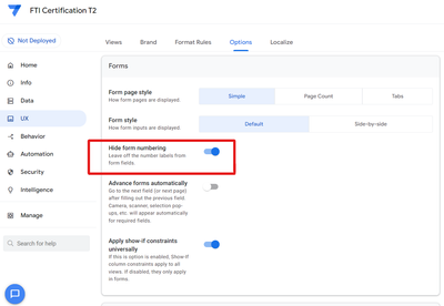

This is my first attempt at making an app using AppSheet, so far, everything has worked well except I am not finding a way to remove the automatically assigned numbering that is being displayed in front of each line of data in the form view of the app.
I have utilized the card view template to build a basic knowledge testing platform and have been able to get the app to function as required.  The only issue I have currently is that the numbers displayed are a bit of a distraction, they don't correspond to any of the sheet data that I have provided, and progress sequentially starting at the number '2'.  It wouldn't bother me as much if the numbering started at '1', but starting at '2' is making my brain itch.
I've stumbled through every setting for this particular page but have not found anything that allows me to remove the numbers at the front of each row displayed.

Setting found!  🙂
I couldn't leave things alone.

Setting found!  🙂
