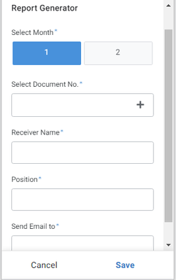

I make a report generator and tries to combine two different tables however it returns error. I am not sure whether I am doing it right with the syntax. Can anyone help?

It is not a list though, It is supposed to send back the information that user fill in for the report generator table.

User should be able to select multiple documents and generate report for each but value for the name and position should stay same for all report. Can I know more about the VLOOKUP tho?
