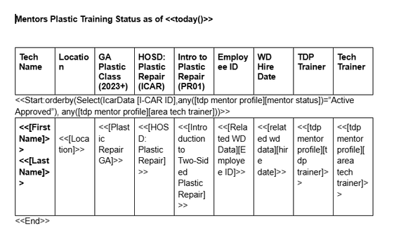

I have an emailed report that is scheduled.  I last modified the template on 12/2 at 1:19pm and successfully ran a test subsequently at 1:23pm.  I have the emailed report.  This week it did not run as scheduled.  Upon attempting to manually execute it, it failed.  The report now generates an error when tested as follows:
Task 'Send Mentor Plastic Report' Body template. Expression 'orderby(Select(IcarData [I-CAR ID],any([tdp mentor profile][mentor status])=โ€Active Approvedโ€), any([tdp mentor profile][area tech trainer]))' is invalid due to: Expression had error..
Which needless to say is not very specific or helpful.  Nothing has been altered in the template or app.  However, I did open the app and it did a "consistency update" on its own in between.  Any ideas what could be going on?  I don't see any obvious problems.

Don't know what your column types are, but it sounds the ORDERBY() doesn't know what column it should use to sort as you are using ANY() for that purpose
I thought that might be the problem as well (despite it running successfully with the "any()" in place last week), so I removed that as the sort parameter and replaced it with a "normal" column instead.  Still get the same error.
So.. what is your new formula and what is the error message?
Task 'Send Mentor Plastic Report' Body template. Expression 'orderby(Select(IcarData [I-CAR ID],any([tdp mentor profile][mentor status])=โ€Active Approvedโ€), [location])' is invalid due to: Expression had error..
Your ORDERBY() expression is missing at least one argument.
Steve, can you elaborate?  I'm not seeing what you believe I'm missing?  Orderby needs a list of keys and a parameter to sort by separated by a comma.  My select() function provides the list of keys separated by a comma, then the any() function provides the sort parameter.  What might I be missing?
Again, the strange thing is that this template ran successfully last week and no changes have occurred since then to the app or the template other than an automatic "consistency" update applied by the editor when I opened it to glance at something since then.

Here's a very similar expression used in another template that executes perfectly fine, I don't see any difference in syntax:
orderby(Select(Trainees [RandomID],[current status]=โ€Active Approvedโ€), [area tech trainer])
Guys, I'm finding now that across the 13 apps I maintain, I'm receiving this same error on various *previously working* reports.  Some have been running on a routine basis for over a year and have not been modified.  I believe Appsheet has made a back-end change that is producing this problem.
Update:  I found across 3 apps 4 reports not working, some of which have been running for over a year with no problems.  All involve the use of this sort of dereference in the template code:  [Some reference][Some column].  I don't use this frequently so it was easy to spot as a common thread.  I am working with support now, I assume Appsheet has introduced a bug.
Update:  Support is still working on it.  The issue seems to center around select or filter functions that make use of [Some ref][Some column] to generate a list of keys producing errors now when they did not in the past.

Does that ORDERBY() expression work as an App formula of a virtual column?
Please post screenshots of the following:
  • The columns list for the IcarData table that includes the I-ICAR ID and tdp mentor profile columns.
  • The Type Details section of the configuration of the tdp mentor profile column.
  • The configuration of the Send Mentor Plastic Report task.
  • The body template, including at least the entire <<>> tag that includes the problem expression.

Thanks for your help, here goes:
I am not sure what you're asking me to do about the orderby() in a virtual column.  I tried swapping that code out with a simple column rather than the any() expression with the dereference and it made no difference in the error.  Again, this whole thing worked perfectly fine as-is on Dec 2nd.
Not sure how much of the following one you want:
It is worth noting perhaps that in this case (this is 1 of 4 previously working reports that ceased to function that utilize a list dereference in the select or filter function of a Start: statement in the template), every time I use [some ref][some column] it is a 1:1 relationship.  There can only ever be 1 result in the "list".  Appsheet always "assumes" many:many (or perhaps 1:many), but that is not how this is designed from a database perspective.
As per your screenshots, the SELECT() and its content should work, but for some reason it doesn't. I would guess the reason is coming from this part ANY([...][...]) because when you tested ORDERBY() with a simple column, it didn't solve it. If you modify it like ORDERBY(SELECT(....,TRUE),[Your column]), does it work then?
No effect.  Already tried it.
Task 'Send Mentor Plastic Report' Body template. Expression 'orderby(Select(IcarData[I-CAR ID],any([tdp mentor profile][mentor status])=โ€Active Approvedโ€,TRUE), [I-CAR ID])' is invalid due to: Expression had error..
I meaned Orderby(Select(IcarData[I-CAR ID],TRUE), [I-CAR ID])
Well, of course it works then ๐Ÿ˜.  We've eliminated the known issue of [some ref][some column] in the select statement doing that.  We know that's the source of the bug.  Whatever changed around Dec 5th is what stopped that working.
Elaborating, I have built literally 100+ similar reports (if my organization was cookie monster, reports would be chocolate chip flavor)... The only ones that started failing after Dec 5th or so were the 4 that use [some ref][some column] in the select/filter.  All the others are fine.
Have you also tested what happens with Orderby(Select(IcarData[I-CAR ID],any([tdp mentor profile])="something"),[I-CAR ID]) ?
I made a small test and yes, it's a bug. When using ANY([...][...]) it doesn't work with the SELECT() or ORDERBY(). One workaround is to write it as..
