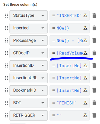

In STEP 3, values that were returned from the Appscript Task and a value that was returned from the ReadVolume process in STEP 1 are written to the record.  It is in this step that the called process's value has been replaced with an empty string "" or possibly null as this is written to the column.
I have examined the monitor for the bot run and stepped through the list of Inputs and outputs and can verify that the value that should be inserted into the column CFDocID is passed correctly from the process in STEP 1.
Somewhere between STEP 2 and STEP 3, the value is being lost from memory or perhaps being overwritten/dropped in the backend of Appsheet.
Again, this happens randomly...but it is verifiable that the value is passed correctly in STEP 1.
