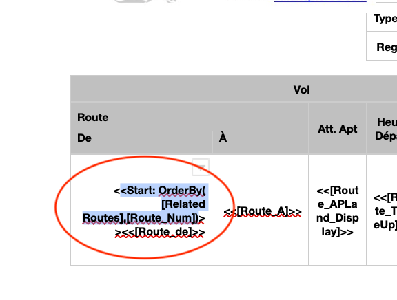

Is there a way to tell the app that Route 1 has to be the FIRST in the UI
Can I do the same thing in the HTLM Export to PDF (has it's Integral to the process to have a pdf)

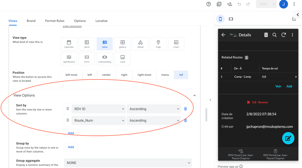

Hello !! thanks so much for your time, I ended up fixing it with a bit of your input and a bit of mine lol
I first Went in the UX Panel and sorted the "Route" view by "Route_Number"
Then in UX, Options, I turned OFF user sorting, has we don't need that in my case anyway
Finally, I used the "OrderBy()" Expression in the PDF generation to do it,
I tested it , working flawlessly, Thanks SO MUCH for you time, sorry for the earlier rant, but it gave me the kick in the butt i needed !

When you're dealing with connectivity issues, these scenarios must be handled with care (as you've found).
Orderby() will help put things back in the order you want.

Any place where you're using the "list" of things.  Generally this is inside your document creation template.
<<START: [Related Whatever]>>
           BECOMES
<<START: OrderBy([Related Whatever], [Order_Column])>>
