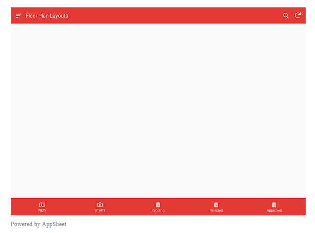

When I run a bot to generate an email, with an HTML template, the bot works, sends the template, the data in the template table is correct, except for one thing... The SNAPSHOT() function shows a blank app screen as shown below.
This is the line of code I'm using in the HTML file to call the XY MAP view. I don't get any errors. It's just a blank, as if there's no data...?
I have set the bot to bypass security filters.
<<SNAPSHOT(LINKTOFILTEREDVIEW("Layouts", [id] = [_THISROW].[id]))>>

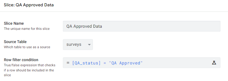

I have a QA APPROVED VIEW
Which looks at the QA APPROVED DATA SLICE of the surveys table.

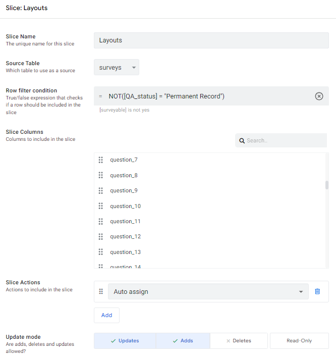

At this point, would you please mention how the table/slice used for the "Layout" view is related to the "Surveys" table?
Hi @Suvrutt_Gurjar... Your extensive testing and perseverance is much appreciated... ๐Ÿ˜‰
I will go ahead and also test this approach: LINKTOFILTEREDVIEW() applied on a general detail view and not a map view
The Layouts view uses Layouts slice on the surveys table, and has an updates and adds relationship.
Thank you. I think slice expression for the Layouts view also looks good. Since slice has an expression of NOT([QA_Status]) ="Permannt Record"), it should select all the records such as [QA_Status]="QA Approved" which is a status for the other slice and the bot firing condition.

Edit: My one request to you will be to base the "Layouts" view also on the slice "QA Approved" just for testing purpose and test if the SNAPSHOT(0 function works. In my testing , one difference is I do not have two different slices. In fact both the views are based on table.
"...one request to you will be to base the "Layouts" view also on the slice "QA Approved..."
@Suvrutt_Gurjar, you are a rock star dude...!!! Thanks for not giving up!
Pointing the Layouts view to a new slice did the trick...!!! Here's the result... ๐Ÿ˜‰ ๐Ÿ˜ ๐Ÿ˜Ž
