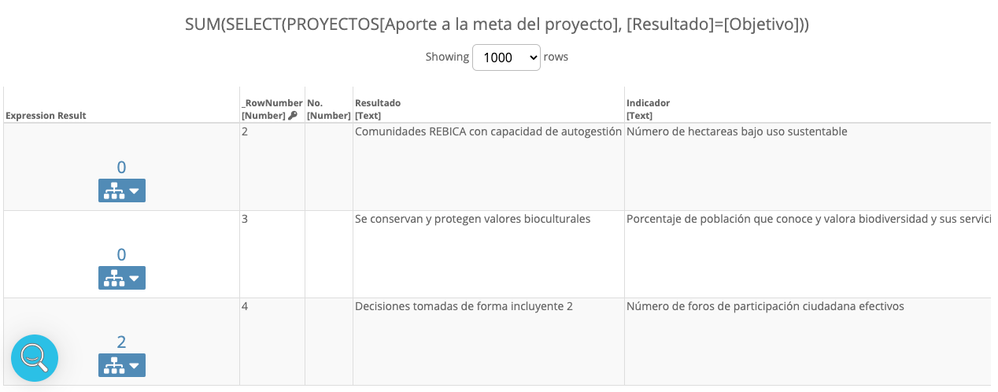

Thanks @Steve! Did this work for the formula.
Im getting the correct results on the Test:
Although the column is not being shown nor the table is being updated…

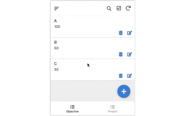

Im sorry Steve, I must be doing something wrong.
This is what I get:
The actual table in Google Sheets is not being updated, neither the deck view for “Objectives”, but when I click to edit an objective in a Form view I can see the value.
Which is what I think you meant here:
" Try opening one of the existing rows in a form and Save (without making any changes, even). I expect the sum will then be computed."
This does work, but I need this to happen when a form is saved in the Projects View. I actually dont want the Objectives to be editable by the user.
