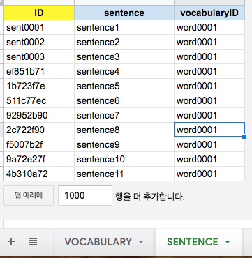

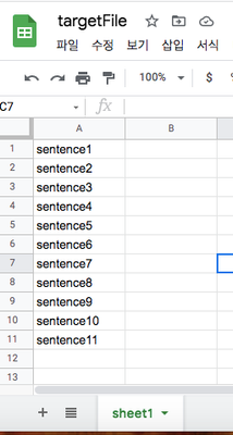

Title : To copy "AppSheet Data" to "Google Sheet" by Apps Script
Like below image, I have copied the sentence column of AppSheet to sheet1 of Google Sheet(targetFile).
     <AppSheet Data : sentence column of SENTENCE table>
leinharte_5-1651136775826.png.
<Google Sheet : sheet1 of targetFile>

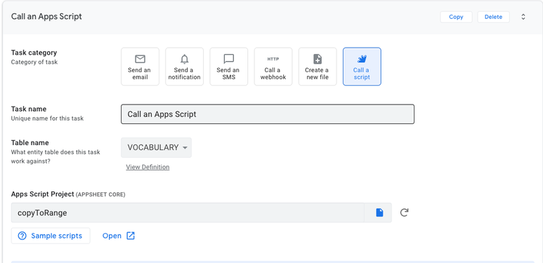

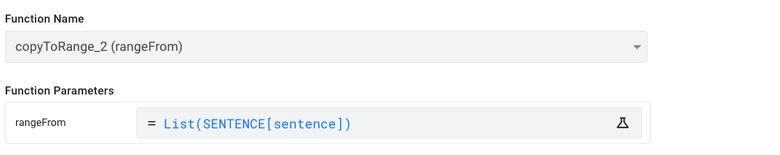

step2 : Automation :
Make a bot and a task like below.
<bot>
<task>
โ€ป For 2D array, I used List function : List(SENTENCE[sentence])
