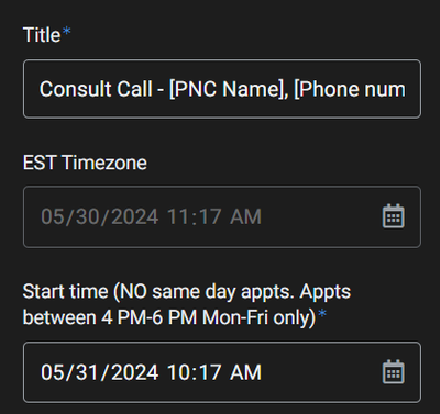

I've found a use for your solution as a guide so that other users will know the time difference instead. Here's what it looks like now in my app:
Thank you very much for the assist @MultiTech!
