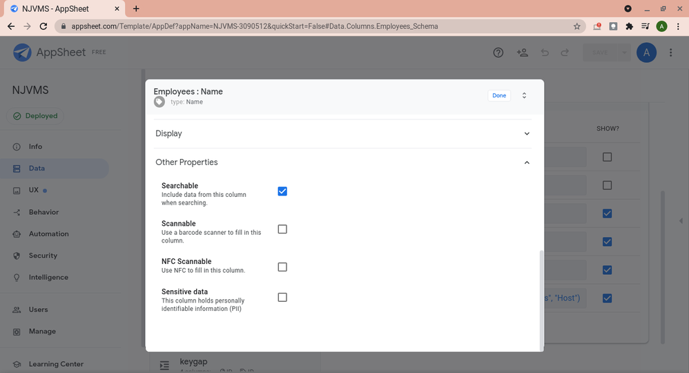

Could you share the configuration (The view you get when clicking on the โ€œpencilโ€ icon when in the column editor) of this particular column that youโ€™re trying to search in the form?
Make sure the column containing the values displayed in the dropdown is marked as searchable. If the column is of type Ref, make sure the label column of the referenced table is searchable.
Both the columns are selected searchable.
Also find the screenshot of the configuration of particular columns.
Due to ID duplication in the reference table, the search was causing issues.
