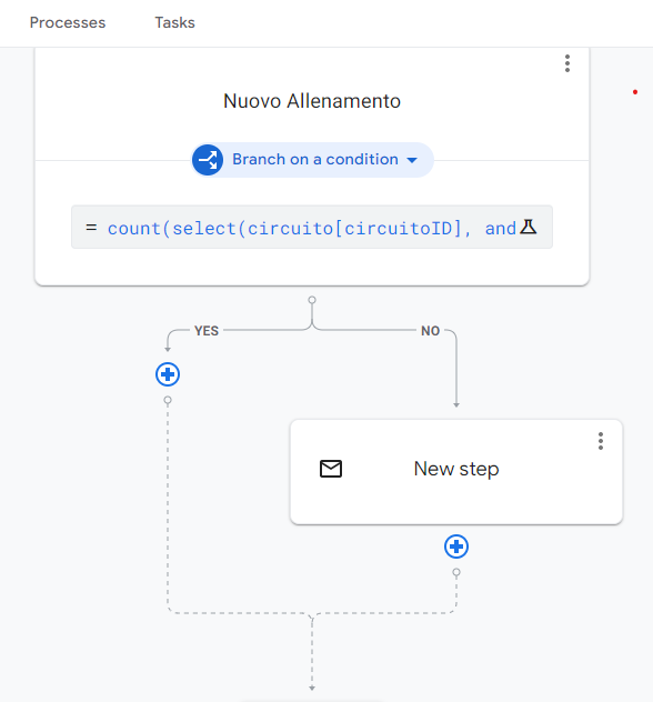

 count(select(circuito[circuitoID], and([EMAIL]=USEREMAIL(),[Datains]=today())))=1
I TRIED TO ADD THIS CONDITION BUT IT DOESN'T WORK

OK forgive me, I try to explain myself better. So, I would like to set up a bots that sends me an email when in the specific case of the insertion date the data is entered, but since it is a training card, the data to insert, so the date would be at least 10 if not more, so it would be enough for me to receive only an email always filtered for useremail () in order to be notified that that USER is using the app. otherwise if I didn't do this I would receive at least 10 or more emails, which multiplied by users would be too many.
I tried with a count but it doesn't work for me, the after-before function works but only for the box that will undergo the modification, while I would like that before modifying the box, it should check the previous one so that if it is equal to the value that I have to enter i send no email. thank you
