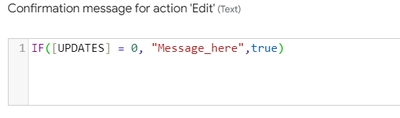

1) Create a column and name it UPDATES (or whatever you want) and set this as changecounter, so it will count the updates for this row. If you're adding a new row, it will be zero.
2) Go to the edit action settings and in the Behavior enable the option "Needs confirmation?"
and in the confirmation message use an expression just like that:
But if you want a warning every time you update, you can simply set the message without any formula, just need confirmation. but it will appear before the form opens, which is a good thing.

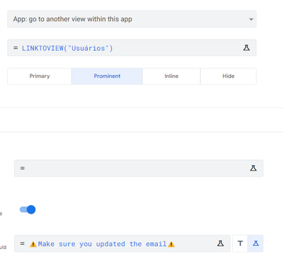

Yes this is possible.
Just make a new action and set it as "go to another view of the app" toggle the "Needs confirmation?" and write the message you want. You can also use some condition in the behavior, if you want to. You need to use the linktoview expression that will take you to the view you want. if you want to be more specific you can use a linktorow it would be something like this LINKTOROW([_THISROW].[ID],"View_Detail") This way you'll be taken to the exact detail you just saved. See below:
After this go to the "Views" and go to the the particular FORM view, scroll down and you'll see one section called behavior:
Here you can choose one action to run after the form is saved, by default it is "go back to details" or something like this. Choose the action you created, and everytime time you save (or depending on the condition you want) you'll see a pop-up window with the confirmation message and after confirming it will take you to the view you want.
Ta-Da!!! This is how I do it.

Yes it is possible too.  Follow the steps:
1) Create an action go to another view of the app then use the formula:
LINKTOROW([_THISROW].[ID],"View_Form")
PS: Replace the view name with the action form view.
2) Use a Needs confirmation and set the message and conditions you want.
3) Call this action: EDIT it will be duplicate and be called edit 2 probably, but you can change teh view name and set this as primary action only for detail views
4) Hide the actual "Edit" button.
READY!!! Every time you hit the edit button you'll receive a pop up message and will be directed to the form related to this row.
