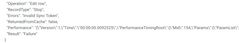

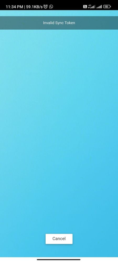

Some user facing error : "Invalid Sync Token" on the appsheet app
Some users reporting that when they try to sync the app, they see an error message stating "Invalid Sync Token" error.
When checking the logs, same was observed.

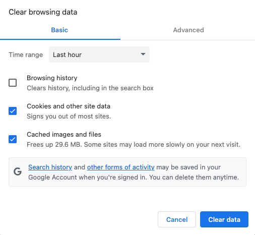

Thank you for this help.  I experienced the problem while editing my app on Google Chrome.  Your excellent advice helped me solve the problem:
I'm not sure if I needed to check both "Cookies" and "Cached images" or not, but doing so worked.
