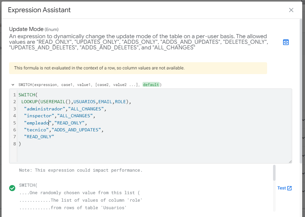

Ok, that's perfect, but the problem is that when an admin or inspect try: add, edit or delete the app fails. For example, when I add a register with a admin user:
I waited a minute but not working, so I push on this button, and:
Unable to add row to table 'Residuos'. โ†’ Table 'Residuos' does not allow this operation. Expression result: 'READ_ONLY'. Expression Trace: {"key": "SWITCH(ANY(SELECT(Usuarios[role],([EMAIL] = USEREMAIL()))),\"administrador\",\"ALL_CHANGES\",\"inspector\",\"ALL_CHANGES\",\"empleado\",\"READ_ONLY\",\"tecnico\",\"ADDS_AND_UPDATES\",\"READ_ONLY\")","result": "READ_ONLY","values": []}

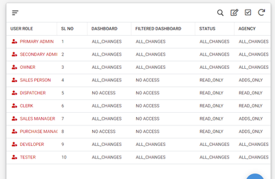

When you have table like what I have done, you can change the user access based on access what you give.  secondly all those access can be edit or changed in the app interface. you need not change in table properties like switch().
It is kind of dynamic user controls. all amendments I do in app itself. I will not change in properties.
there will be 4 tables usually,
1. Users (Organisation Members)
2. Users Roles ( Admin, Manager etc)
3. User Permission ( What admin hold like All changes, Sales person only Adds_AND _ UPDATES etc)
4. Access or Permission Types - optional (It is like Adds_AND _ UPDATES, delete only etc)
This enables you to have like ERP software ๐Ÿ˜€
19 REPLIES 19
As the error description shows , it sounds that the expression is evaluating to "Read_only" result. You may want to double check the email of the user adding the row is evaluating for a role other than admin, inspector or technician which allow adds to the table. Possibly a spelling mistake in roles in the table or in the expression or a small mismatch in email id entered in the Usuarios table than the actual email.

As per my understanding it should work.  My testing also showed it works for me with exactly similar expression. Someone else may have a better input.

I don't understand why that expression doesn't work.
One thing that surprises me when using the expression is that it warns me about:
"This formula is not evaluated in the context of a row, so column values are not available."
I hope someone else contributes some ideas, because I can verify without the expression, but the objective of having different user roles is that the app distinguish the actions that each user can do. Thank you very much anyway!
That  warning you have highlighted is a standard warning for certain settings such as view display names , localization settings and this setting. However in this case the expression uses USEREMAIL() to identify the record in the USUARIOS table, so it is not a problem.
One thing.. open the upper left hamburger menu from the emulator and check what email address you are using with the login.

I read your thread, but to do what you propose here I should have 3 different tables, right?
Maybe I could do it with my only "Users" table?
BRO THANK YOU SO MUCH! Thanks to this solution and your thread I have been able to solve my problem, I already know that the switch here is useless and that I really have to do this. Thank you very much again.
Yes , switch () is nearly useless.
Deploy Dynamic User Access and if you wish to disable (making not visible) any view to any user roll then use the lookup expression <> "No Access" in showif option of particular UX - VIEW.
 If you have any trouble in implementing this let me know.
Thanks for accepting my reply as solution.
