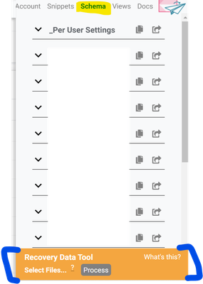

And a post to deal with the data recovered, here:
https://www.googlecloudcommunity.com/gc/AppSheet-Q-A/Best-Practice-for-Data-Recovery-from-quot-Recov...
And a way to process recovered data quickly, with the AppSheet Toolbox extension :
Thanks @Aurelien the extension he has open while viewing this can be found here in case it helps you as you work in AppSheet.
https://www.googlecloudcommunity.com/gc/Tips-Tricks/FREE-Chrome-Extension-that-enhances-the-Expressi...
