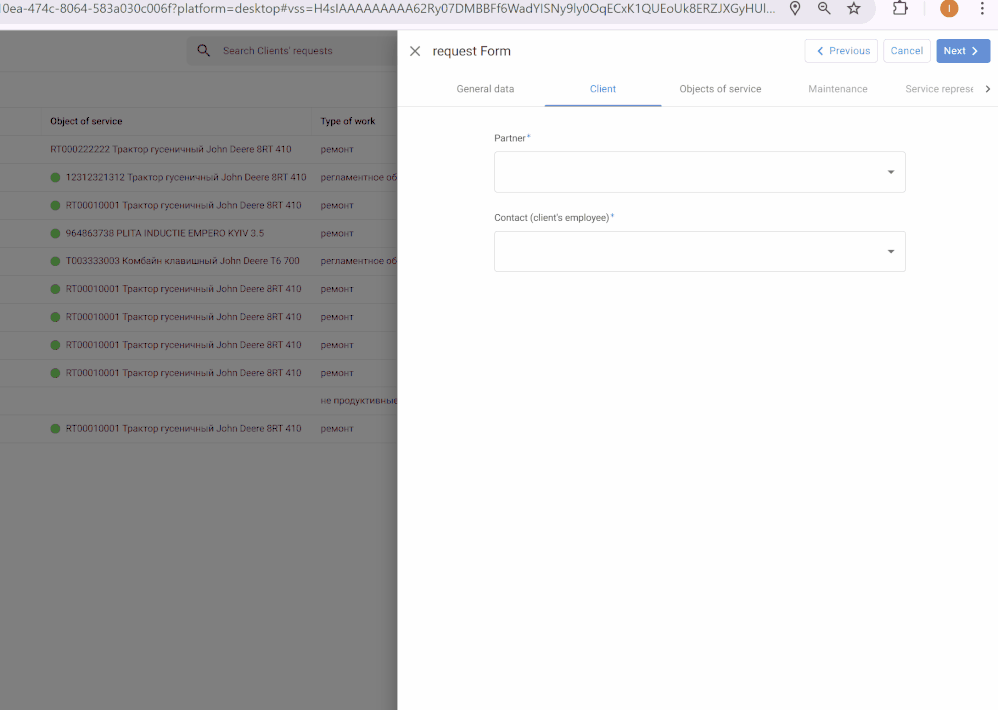

I have MySQL DB
Part of structure:
When creating a Request directly from his form, I add both the new Partner and the Contact Person associated with him, then an error occurs when trying to synchronize.
Judging by the json update, AppSheet first tries to write the Contacts table, and only after that Partners, and of course it fails, because it does not find the necessary key (the partner has not yet been created, and we are trying to write his contact person)
Question - on what principle does AppSheet build the sync queue and is it possible to somehow configure this order to avoid such an error?

I tried this way. With this approach, the situation changes a little: The Partner is saved and synced, but further syncing also fails, since the queue is built Request->Contact. Any ideas?
