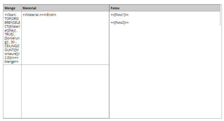

In Google Doc I build a PDF template with Nested Tables.
You can see some extra space above and under the nested tables.
I want to get rid of these extra lines.
I can’t delete them.
I can set the font size to 1 and the Line spacing to 0.06.
I can set the Cell vertical alignment to “Top” and the Cell padding to 0.
So in Google Docs they would disappear.

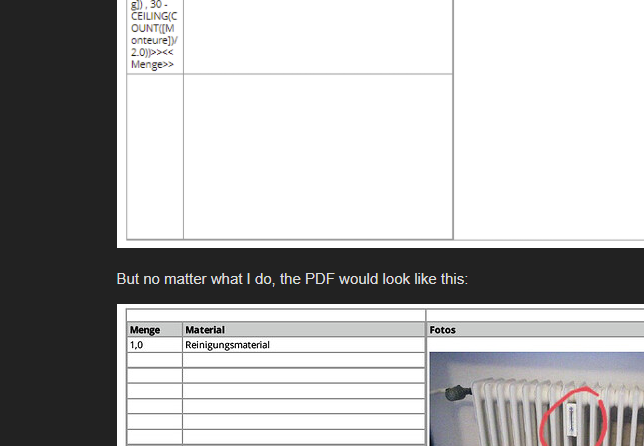

But no matter what I do, the PDF would look like this:
Adding @Phil
Here is the sample Template:
Note: these are 3 tables: 2 nested tables in 1 table. You can set the border color to black to see where the tables are
Note: The empty row is not empty. It contains an expression in white font.
My goal is simple: I just want to put a grey border around the 2 nested tables.
1 7 1,872
I was able to solve it with a funny workaround
I had to put some text into the cell that I want to hide.
Now it will respect the font size. So If I set the font size to “1”, the outer cell disappears.
So I just put a space into the cell and set the text color to white.
Now it looks perfect.

You’re correct. I think that’s what he meant by nested tables. In a template to be able to display columns of templated data, in many cases you will need to create an outer table as a container and then insert tables into each cell that the data goes into. Some blank examples below.
Basic 2 column table with a “child” 2-column table inserted into each cell
Same table with Padding removed (set to zero) for each cell of the outer table
See the space above and below the “child” tables. No matter what you do you can’t get rid of it. After playing, I think this is by design because if the table borders actually aligned, you wouldn’t be able to select certain cells.
Setting the outer table border to white color produces a look like this.
There is still spacing used up in the template by the outer table and note the gap between the two child tables.
