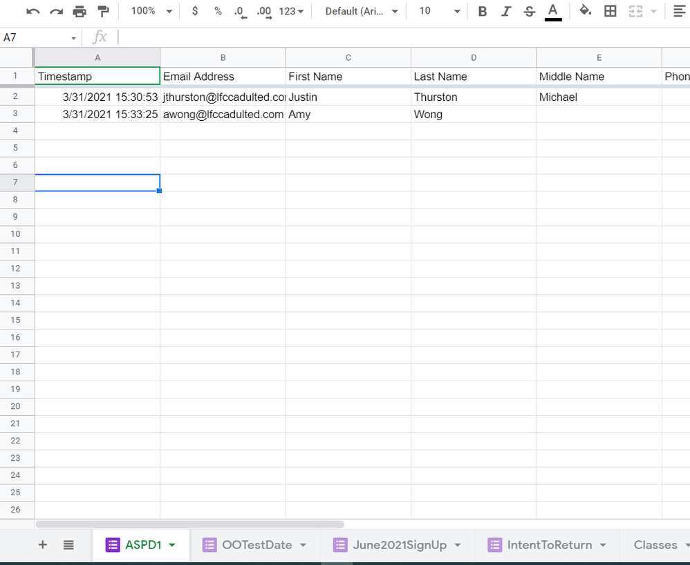

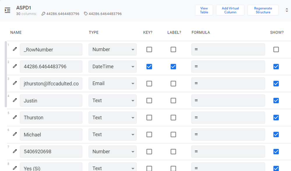

I’m very, very confused. I am trying to create a table from a worksheet in Google Sheets. In the Worksheet, the first row has the column headers. But when I generate the table, it is pulling the column headers from row 2. I’m trying to understand why this is happening, and how to fix it. Any help you can offer would be much appreciated.

Make sure the first row–and only the first row–is in bold.
Thank you!! I was able to regenerate the structure and now it’s working.
I am curious as to why this happens. None of my other worksheets have the first row in bold. Would bolding the first row of my existing worksheets be a good idea? I’m afraid that I might regenerate their structure in the future and run into the same issue.
