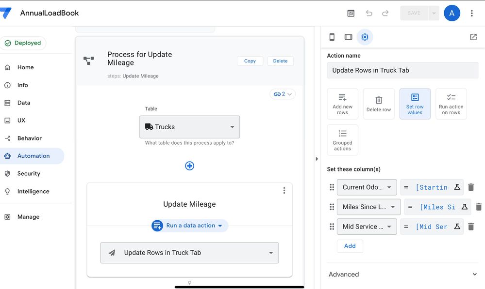

Itโ€™s only three columns. in truck table
I also tried to add the process for Updating Mileage to the BOT for notification when a , New DATA record is created
However testing it isnโ€™t working
With what you said probably something like this would work better
Thatโ€™s not workin either
Yes, this last one should work.

It worked to transfer the DATA from the appropriate colums.

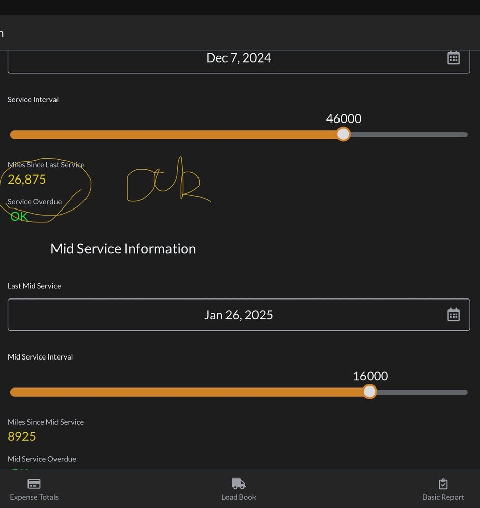

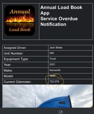

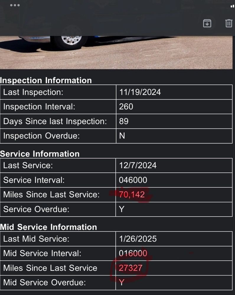

However when it transferred it adds mileage that is incorrect.Correct in app viewCorrect in app viewIncorrect in the emailIncorrect in the email
I have tried many different ways and for reasons unknown to me
The only way that the sums are the same in the app view and the form view is with static columns not virtual columns
However I need the sum to update every time that a New DATA record is made.
A virtual column updates the sum automatically
The static column only updates when the table is edited and saved
I found the solution by redoing the Expression that figures the math sum of the mileage after a specific date the totals sum for the appropriate columns is correct in the app view and the email notifications.
