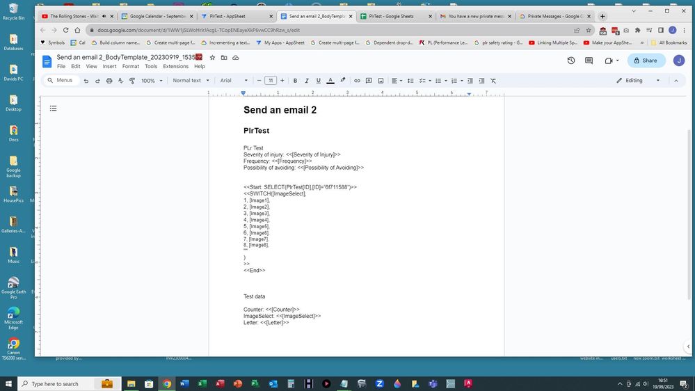

Trying to use Switch in an email body template to load one of several images but failing
I am trying to select from one of 8 images in an email body template. The switch reads a value from the row generated by the form, but I want to select one of the images from only the first row in the sheet, as otherwise all 8 images would have to be loaded every time.
The switch statement doesn't work successfully, either the email automation doesn't happen, or if it does, it ignores the switch.
See below for the template code and the sheet layout.
Grateful for any help!
James

Oh this was solved by using a thisrow argument:
<<Start: SELECT(PlrTest[ID],[ID]=โ€6f711588โ€)>>
<<SWITCH([_THISROW].[ImageSelect],
1, [Image1],
2, [Image2],
3, [Image3],
4, [Image4],
5, [Image5],
6, [Image6],
7, [Image7],
8, [Image8],
<<End>>
I'd be grateful if you could point out the error? I can't see that it's wrong, the first value is numeric, then it should choose the column value?
So the correct format should be
SWITCH(expressioncase1value1, [case2value2 ...], default)
And I have
SWITCH(ImageSelect],1,[Image1], etc ... ""
ImageSelect column is of type Number.
1, 2, 3 etc are numeric values.
Image1 is the column containing the image that should load in the template?
