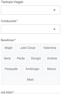

I managed to have the app calculate e cost of trip (by time and km). Now I have an EnumList  columns (that takes the names from a Worksheet) with the Names of the User of the car for each trip
The driver encharged select the names of users fo a specific trip in this EnumList column in the App.
So the result is "name1 , name 2 , name 3" ... (btw I would like to limit choises to 5, but couldn't find how).

The EnumList had the advantafe that in just one place I had the button for each passenger to be chosen by the User
My idea was: the user choses between names, otherwise I should put 5 columns one for each possible passenger ... but hten I don't know how i can connect it with the child table. But maybe this is the most straight forwardsolution

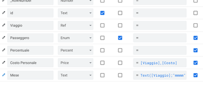

Now I'm tryig to dereference the cost column to make calculation (multiply the total cost for the percentage of each passenger) on it and the reply is:  "The expression is valid but its result type 'Ref' is not one of the expected types: Price"
[Viaggio],[costo] ... -> where viaggio is the ref column in the child table anda costo is the column value i'm interested in ... cannot see why. This formula is in the column Costo personale that is formatted as "price"

when I manage to "test" this formula [Viaggio],[Costo] that is in the Column [Costo personale] -Price Type- in the Child Table  the result is the content of [Registrazione] where:
  • [Viaggio]: Child Table - ref type- ... should be my doorway in child table to acces parent table as I understand
  • [Costo] Parent table column from which I want the value - Price type-
  • [Registrazione] Parent table -ref Type- my doorway in parent table
andreagiordano_0-1675348483995.pngFrom Child table

It looks like you're using a comma in the dereference expression, should be a period.
Your virtual column is type List, change it to yes/no to match the expression result.
