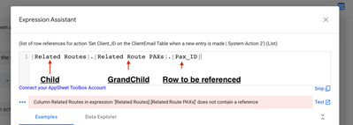

I want to do the same thing, pass the "Client Name" to a field in a Grandchild table, but to do so, I need to bind the "Input" action, to the "Host" table, my problem is, how would I reference My Grandchilds row ? I've tried using this :
[Related Child].[Related GrandChild].[stuff that I need_ID]
But i'm getting this error.. :
Column Related Routes in expression '[Related Child].[Related grandchild]' does not contain a reference
Now Obviously, there is something i still dont understand as to HOW to reference multiple tables together, question is : What?

[Related...] is a List of Refs, not a single Ref. You can't use the dot-notation to dereference a List of Refs. You can use List dereference, which just excludes the dot, like [Related...][col in child table], which will return another List. However you can't chain list dereferences, which means you can't do either [Related...][x][y] or [Related...][x].[y]
Also keep in mind that this field expects a List of Refs, not a single one. If by chance you're only giving it a single Ref value, make sure to wrap it in LIST()
You'll probably just want to manually construct a FILTER expression in this case. Perhaps something like:
FILTER( grandchild , [child].[parent] = [_THISROW] )
https://help.appsheet.com/en/articles/4575708-list-dereference
Edit. On second thought, I think [Related child][Related Grandchild] might be all you need?
