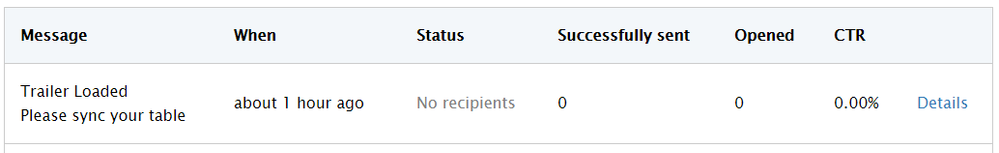

I have created a workflow that triggers the notification through Pushpad and can see it via Pushpad, but cannot figure out how to get this to my users or me for that matter.

As you can see I haven’t any recipients which is where I think I am stuck at the moment.
I don’t know how to add my current users as recipients, any clues?
@Chris_Jeal
Your users need to install Pushpad app as well to their mobile devices. The installation will create a unique User ID for each installation and with those IDs you need to create recipients or recipient groups as per those IDs.
