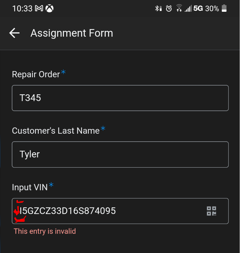

Why does the barcode scanner add an I to the scanned value anytime our techs scan a VIN on a vehicle
the barcode scanner keeps adding an I to the beginning when scanning a vin barcode on a vehicle? it is doing this using the default scanner and the scandit 3rd party service.Screenshots_2022-10-27-10-35-05.png
 The validation rule constraining the result to be 17 characters (exact character count of a VIN on a vehicle) allows the tech to delete the I but when you are on strict time constraints and scanning 15 to 20 cars a day it is annoying.

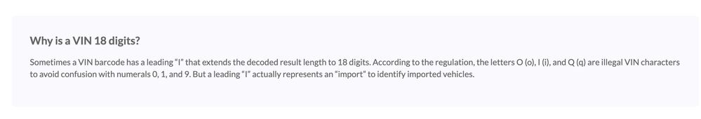

Now that you have this additional specification, it is obvious the barcode and VIN are not the same thing.  I would suggest introducing a separate column for the VIN and keep the current column as the VIN Barcode.  I would NOT modify the barcode. It may be vital for something later.
When the barcode is scanned, use an expression in the new VIN column to extract the 17-digit VIN.   Then use this new column to submit the NHTSC service.
yes it is indicating it as an import. you need to have a column to insert
the data the scanner extracts the a second column that formats the vin
using the LEFT() and RIGHT() functions. you should also be aware that chevy
includes over 50 word values in their vin codes describing the vehicle
equipment like engine size etc and will need to incorporate into your
formula.

Formats the VIN number when using the barcode scanner to remove additional vehicle properties stored in the barcode and cause it not conform to the 17 characters and will cause error if automating vin decoding.
Imports typically include an I in front of the VIN when scanned, GM will include all vehicle properties in the vin and can exceed 100 characters +.
This is proven and tested in production enterprise application currently deploy for my company and is used 50-60 times a day every day.

Why do you think the barcode itself doesn't include the "I"?   Where is the barcode coming from?  Maybe a mistake was made in the generation of the barcode?
A quick search comes up with the below.  It appears the "I" is a valid part of some VIN barcodes.  You will need to research this, its usages and understand how to handle it in your app.
is there a way to have the i removed before adding the value to the spreadsheet when synced? the api connection to NHTSA does not recognize it as a valid vin with the it and it performs the call as soon as the value is added to the spreadsheet.
After trying this out it is a much better solution. Its efficient, simple, and although ive never run into a situation in 8 years as a Nissan technician needing the 18 Bit especially since I is character that typically is unused in a vin since it looks like a 1, i imagine if i ever needed to create a slice or filter import cars from domestic it would make for a perfect identifier for automation.
because it has happened on 6 cars now. it is scanned from the sticker on the inside of the car door or other various locations on the vehicle with the vin number displayed with it and it is always an I at the beginning.
the validation rule is how we were able to catch the scan error.
CORRECTION:
Please see willows reply for easiest most efficient solution concerning the import digit handling when scanning a vin barcode on a vehicle.👍
Why don't follow @WillowMobileSys's suggestion which is way simpler? Just add another column and leave the barcode one just for input purpose
i hadn't seen his post until after i made my previous solution which worked for all purposes but was more expensive processing and sync wise and a lot more leg work to integrate.
