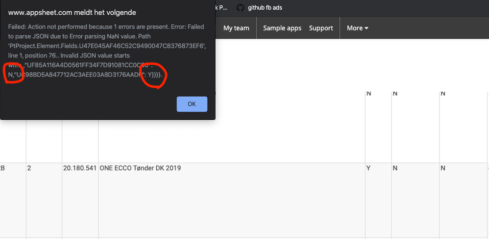

As far as i can tell Appsheet does make a Y, based on this message below.
Sorry @Remco_Edelenbos it’s my bad…The toggle button (Y/N type column in Detail View appears as a toggle button) records it as TRUE/FALSE
Yes, in my google sheet is records as a true/false but. As you can see in my screenshot above, Appsheet record it as Y/N. you can also see it in the table behind the message.

when evaluated, SomeKey parameter shall take a Boolean value of TRUE/FALSE no matter what display value you are seeing inside the AppSheet app. Can you please post or take a screenshot of your JSON body?
