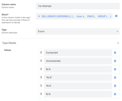

Hello I am having the following error for one of the user.
Message: Unable to add row to table 'Tracker'. → Value 'N/A' in field '1st Attempt' cannot be converted to type 'Enum'.
Please see images below

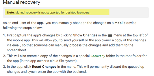

The problem is the user is still using the version of the app without the fix. The user will need to discard their pending changes. See the article below for help with that.
Errors and warnings during Sync - AppSheet Help

Hmmm, do you have the right Format for the column in the backend datastore - text type?
Yes. the back end data has the correct data type
Hi Steve,
Thanks for the time on checking my concern. Will try your solution tom. and will provide feedback. I guess the one I should use is the recovery mode? as the user is encountering the problem on desktop browser.
There is option for recovery mode and avaible, but it is not really practicable. I never used and asked users to do so.
Hi Steve,
putting the app on recovery mode resolved the problem.
Thanks for the help
