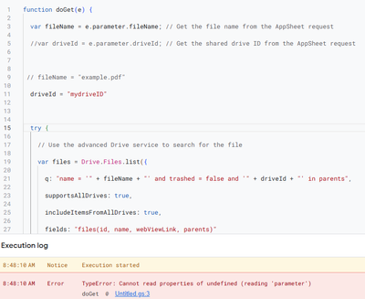

I have a code in Google Apps script that I am using in an automation in my app. It is not working, I want to obtain the link of my pdf file, but the column is empty when I trigger the automation.
How can I use a kind of "log message" , I need to see what happens with the script in appsheet, why the link is not written in my column?
Thank you for your help!
p.s. in google apps script in Execution, there is errors: if I activate "return values" - TypeError: Cannot read properties of undefined (reading 'parameter') at doGet(Code:2:20), if I  activate "return values" but without give something in "Specific type" - "Name", this error : "TypeError: Cannot read properties of undefined (reading 'fileName') at doGet(Code:2:30)".

This is the code:
function doGet(e) {
  var fileName = e.parameter.fileName; // Get the file name from the AppSheet request
  //var driveId = e.parameter.driveId; // Get the shared drive ID from the AppSheet request
 // fileName = "example.pdf"
  driveId = "mydriveID"
  try {
    // Use the advanced Drive service to search for the file
    var files = Drive.Files.list({
      q: "name = '" + fileName + "' and trashed = false and '" + driveId + "' in parents",
      supportsAllDrives: true,
      includeItemsFromAllDrives: true,
      fields: "files(id, name, webViewLink, parents)"
    if (files.files && files.files.length > 0) {
      var file = files.files[0];
      var fileId = file.id;
      var filePath = file.webViewLink;
      // Get the parent folder name
      var folderName = "Root";
      if (file.parents && file.parents.length > 0) {
        var folder = Drive.Files.get(file.parents[0], {
          fields: "name"
        folderName = folder.name;
      Logger.log(filePath)
      return ContentService.createTextOutput(JSON.stringify({
        path: filePath,
        folder: folderName
      })).setMimeType(ContentService.MimeType.JSON);
    } else {
      throw new Error("File not found");
  } catch (error) {
    Logger.log(error)
      error: "Error: " + error.toString()
Thank you!
Your script request is like:
https://script.google.com/macros/s/your_script_id/exec?fileName=example.pdf
Are you running code on dry?

That is not a proper appscript file to do the task you want.  That function is part of a webapp and cannot be called using an appscript task.

Your e.parameter.fileName- Is it included in your URL script ?
..../your_script_id/exec?fileName=example.pdf
