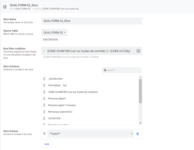

Of course @franc . There is a screenshot of my slice.
For further information, on my sheet I use a formula in each row of each form worksheet. On these row, the value is equal to the code chosen by the user. With that formula, the filter will only show the form answers where the code value is equal to the value of the user, as you can see on that screenshot :
Im a beginner in Appsheet. But if you have any solution that i can work on for my client, i'm willing to listen !
Well, looking at your Excel, honestly, it's not clear to me that the problem with your formula affects only those cases where there is only one text. For example, the values 77 and 88 I don't understand how they can be related to 15A250.
Anyway, the formula you use checks an identity between 2 values contained in two different columns. An identity implies that what they contain is exactly the same value, and I don't see that 77 can be equal to 15A250 unless you first transform it with another formula, possibly in another column, either in Excel or virtual in Appsheet. From your previous explanation, I suppose that the CODE ACTUEL is computed in the spreadsheet through a formula you created. Correct?
Please let me know if I'm wrong but it seems to me that what you want is that when a user types a value, such as "25", Appsheet automatically uses this value to filter through the column CODE ACTUEL and selects the rows that contain this value. If so, to my understanding, you need to use another formula. If my assumption is correct and you want to check that the value, let's say "25", is in the CODE ACTUEL, I would write something like this to filter
IN() or CONTAINS(), or I would use a Select() straight away.
see also https://support.google.com/appsheet/answer/10107681
Please let me know if my assumptions are correct and if this helps you to solve your problem.

This is not about your current issue because @franc is helping you. Just wanted to bring your attention to the column name you have given in the slice.
The column name is very big and contains brackets and even a colon is there. While AppSheet is very lenient most of the times in accepting special characters in various elements such as slices, table and columns, you may want to consider avoiding such column names. If you are using such column names in expressions, it could confuse one while debugging the expressions and at times even give error as expressions also use brackets etc.
Best practice will be to avoid special characters except some like underscore(_)  in element names and keeping those names short.
Thank you for your advice, I will update the name of my headers ASAP.
