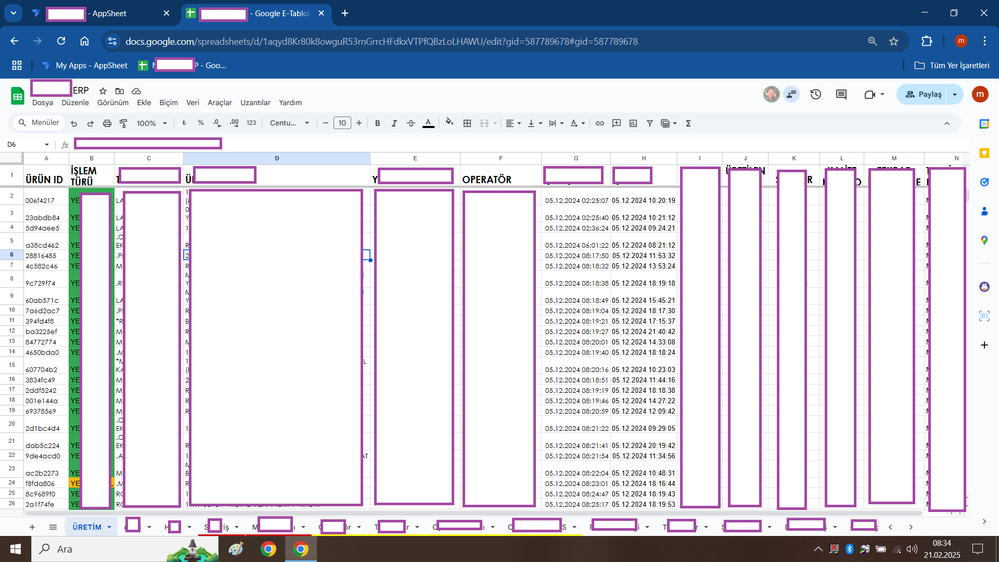

hi. turned into resource planning software. but all the data is in one table. I want to separate it. Will this slow down the application? I collect and process 1000 lines of data daily. I admire appsheet.runrun
So that's not just one table, but many. And from what I can see, you have a fairly well-formed structure. Even if I wanted to, I don't understand your question.
I've reread your post, and I think I understand what you're saying. You have a single Google Sheets workbook, and within it, all your tables. If you're asking about the best approach, from a "storage" perspective, Iโ€™d recommend using a separate workbook for each table and not storing multiple sheets in the same workbook. This is because the maximum record limit per workbook will increase.
