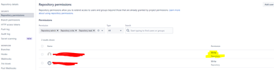

You must create a secret manager with the value of the bot or user private key to connect to bitbucket.
-----BEGIN OPENSSH PRIVATE KEY----- y -----END OPENSSH PRIVATE KEY-----
Then set bitbucket access to 'Writer' in the bitbucket repository.
Finally in the Dataform configuration add this SecretManager and the ssh-rsa key that you use on the server to download the repository.

That's see good,
the only one thing i think,
if you have set the user permissions in bitbucket repository configuration to 'Writer'.
The user must be the same of the secret manager key.
And other thing be carefull with url ssh, must be the same hen you clone tthe repository.
