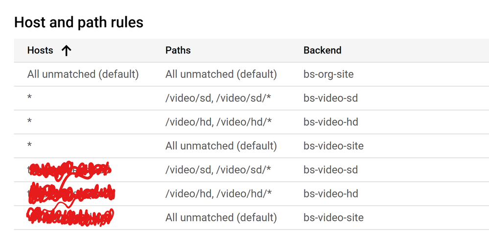

I created an HTTPS load balancer with the following URL map:
I created an SSL certificate for my domain and connected it to the target proxy of the load balancer:
When i go to <domainname.com>, i get the expected output from the bs-video-site backend service.
However, when i go to <domainname.com/video/hd> or <domainname.com/video/sd>, i get the following error:
Not Found
The requested URL was not found on this server.
Apache/2.4.62 (Debian) Server at thestranger.cloud Port 80
I have checked all my backends, and they are in an healthy state.

When i SSH into my VM instance created using the instance group (based off the above template), i don't see the `/var/www/html/video/hd/index.html` path. I only see `/var/www/html/index/html`
So what am i missing here please?
0 3 265
I have been able to access the paths.
I had to update the path in my apache server from `/var/www/html/index.html` to `/var/www/html/video/sd/index.html`.

Hi @mountaincode2 ,
There are various methods to configure URL rewriting. You can check this tutorial blog for another way of configuring URL rewriting. Another potential cause of the error could be a mismatch in port mapping between the instance group and the load balancer. The port configuration on both the instance group and the load balancer should be the same.
