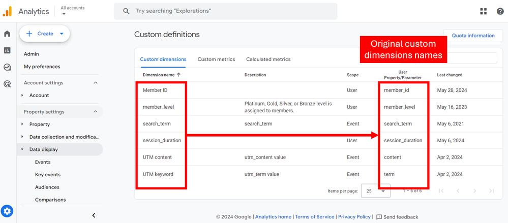

In GA4, custom dimensions have both a 'friendly name' and a more technical name (the parameter name itself). Try searching for the technical name in Looker.

Check in GA4 for the original name of the custom dimension you are trying to locate in Looker. Now, try to find it in Looker using that original name. I'm attaching an image from GA4 to illustrate what I'm referring to.Capture.PNG
but why are you adding search_term, session_duration as custom definition , it is pre defined dimension and yeah that's why you are seeing them. I am having 125 custom definitions, if I gave every name based on google, then why don't even I need such definitions.  Sorry, but, I don't get your logic and what you really wanna do with it. can you please explain?
@tota , I took the screenshot from the 'GA4 - Google Merch Shop' demo property just to show what I'm referring to. Please ignore the dimensions themselves. My point is only about finding custom dimensions in Looker. Sometimes you'll find them under the 'friendly name' you assigned, and sometimes under the original parameter name.
