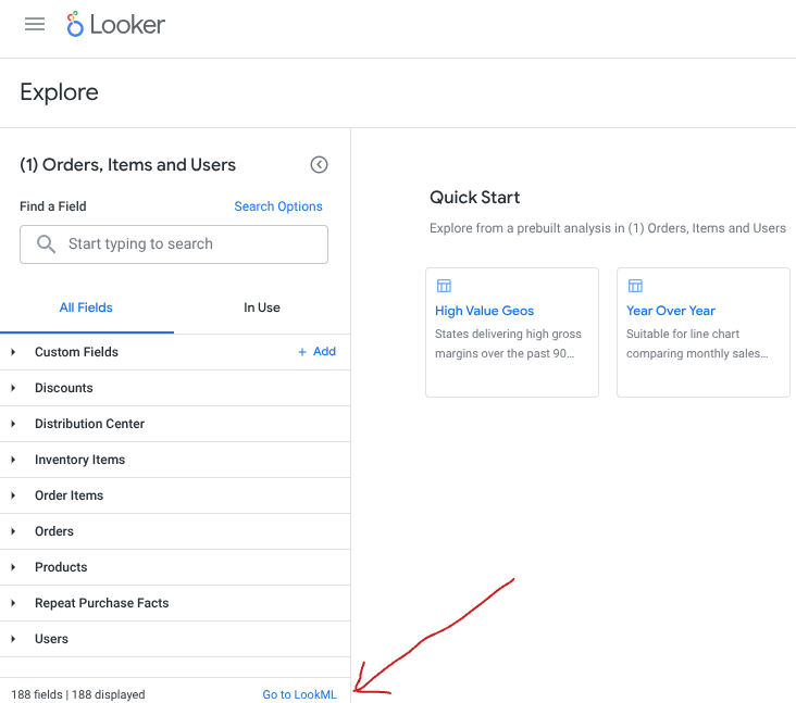

Is there an easy to get to lookml of the Explore (ie not the View)?
From an Explore, it's easy to see LookML of a dimension/measure/etc and get to the View file where the dimension/measure/etc exists.
But is there an easy way from an Explore to get to the LookML that defines the Explore (ie joins) without doing some file search?

Absolutely there is 🙂
In the explore, click on the 'Go to LookML' link at the bottom of the field picker and that will take you to the code for that particular explore.

Wow can't believe I never knew this before
