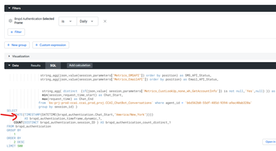

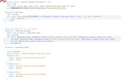

We have built SQL-based derived views, where we created a time frame dimension. This dimension is working correctly in the production environment, but it is not functioning in the Dev environment. The code is identical on both sides.
I have included the code for reference in the attached figure.
If I select “View in Explore” within the selected time frame filter (Day, Weekly, or Monthly) in selected frame filed , the timestamp changes in the production environment. However, in the DEV environment, there is no change sql code in data .
production environment:
DEV environment:
Appreciate your help.
