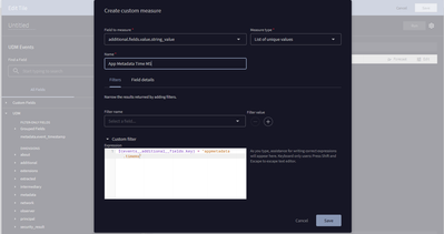

Hi @stosh-malec
How about using 'Add' within 'Custom Fields', selecting 'Custom Measure', and using the below conditions replicating it per Key.:

Are you using Looker or Native Dashboards?
I am guessing Looker.    If you do not have Native Dashboards enabled - we will want to get that setup through the account team or support.  I bet you can get what you are looking for there.  I will investigate as well but I currently cannot - I need to do a little research for those fields.
I believe this would be the native dashboarding tool that I am using while it does say powered by Looker in the bottom left.
Hi @stosh-malec

Thats looker dashboarding.   The native dashboards use Yara-L.
